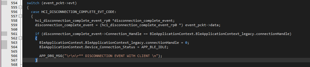

Update: I ran a firmware in debug mode and saw below line not executed under the case HCI_DISCONNECTION_COMPLETE_EVT_CODE
disconnection_complete_event = (hci_disconnection_complete_event_rp0 *) event_pckt->data;
as a result I cannot understand reason of disconnection!

If you retry with BLE Full Stack v1.10.0, does your application work ? Are you able to see the debug trace "DISCONNECTION EVENT WITH CLIENT" in your terminal ?
In order to understand the reason of the disconnection, place a breakpoint on the case HCI_DISCONNECTION_COMPLETE_EVT_CODE and do step by step debug.
