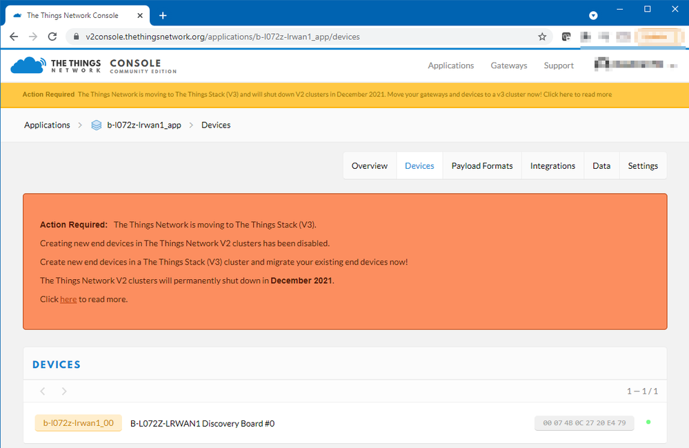

2021-07-06 1:38 PM
What was known as "The Things Network" (TTN) is now "legacy" and not accepting any new devices, gateways, or applications.
Thus, I think, all ST materials referencing "The Things Network" are now obsolete & unusable.

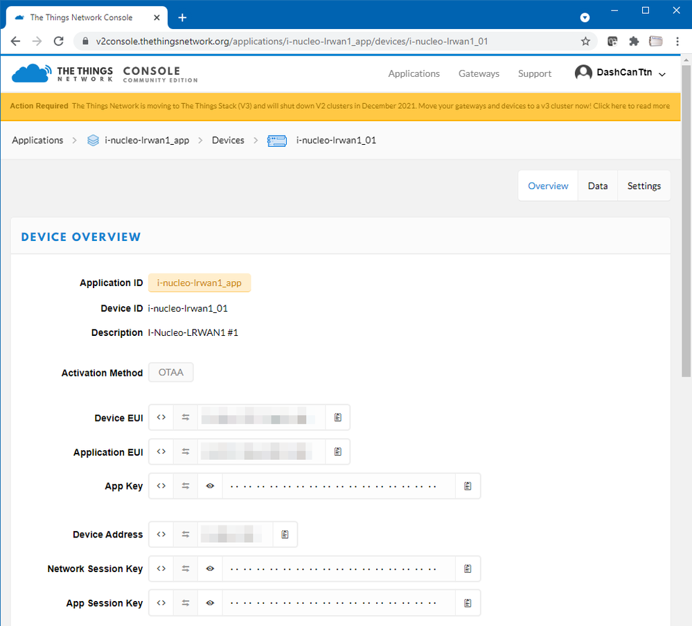

Specifically, these are the configuration parameters presented on TTN (V2):

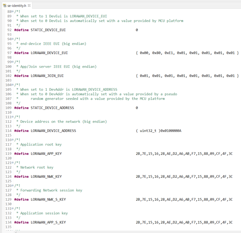

And these are the configuration parameters available in se-identity.h:
Please provide a list giving, for each of the settings in se-identity.h, which of the values from the TTN Console (both V2 and V3) should be used.
#define LORAWAN_DEVICE_EUI
#define LORAWAN_JOIN_EUI
#define LORAWAN_DEVICE_ADDRESS
#define LORAWAN_APP_KEY
#define LORAWAN_NWK_KEY
#define LORAWAN_NWK_S_KEY
#define LORAWAN_APP_S_KEY The table in the file doesn't help:
********************************** WARNING ***********************************
The secure-element implementation supports both 1.0.x and 1.1.x LoRaWAN
versions of the specification.
Thus it has been decided to use the 1.1.x keys and EUI name definitions.
The below table shows the names equivalence between versions:
| 1.0.x | 1.1.x |
| LORAWAN_DEVICE_EUI | LORAWAN_DEVICE_EUI |
| LORAWAN_APP_EUI | LORAWAN_JOIN_EUI |
| LORAWAN_GEN_APP_KEY | LORAWAN_APP_KEY |
| LORAWAN_APP_KEY | LORAWAN_NWK_KEY |
| LORAWAN_NWK_S_KEY | LORAWAN_F_NWK_S_INT_KEY |
| LORAWAN_NWK_S_KEY | LORAWAN_S_NWK_S_INT_KEY |
| LORAWAN_NWK_S_KEY | LORAWAN_NWK_S_ENC_KEY |
| LORAWAN_APP_S_KEY | LORAWAN_APP_S_KEY |
