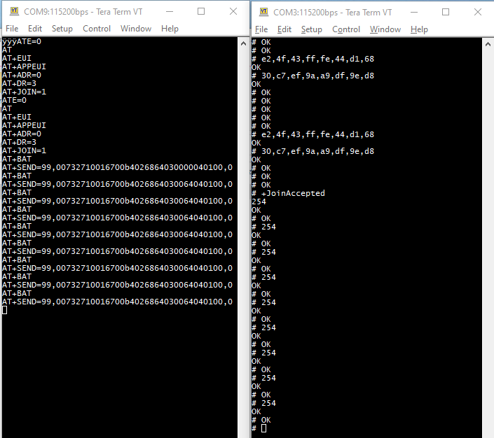

Initially (after fixing the source code bugs) it did join the network, and exchange data:
0693W00000D0eakQAB.pngthis shows 2 TeraTerm instances:
  • the left-hand one is monitoring AT Commands sent by the Nucleo-L073RZ;
  • the right-hand one is monitoring the responses from the I-Nucleo-LRWAN1.
It shows a successful join, and exchanging data.

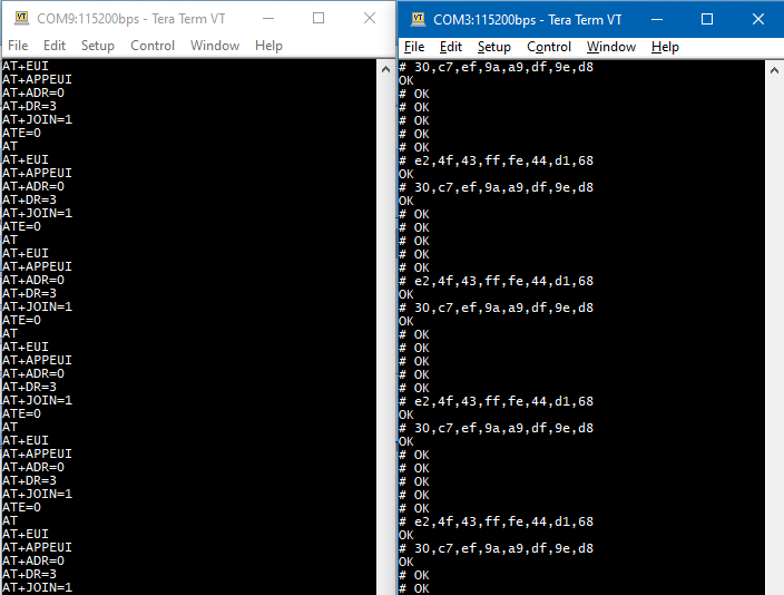

However, after a short time, this also got into an endless join-request loop:
So, having initially managed to join successfully, why would it then get stuck in a continual failing join-request loop?

Should seem that the network do not respond to a Join request. If you look at the initial trace the end-device does a join request , then modem return an asynchronous event "+joinaccept" and btw goes into a Sending periodic frame processing. Now in the endless join-request, should seem that the End-device does an "NVICReset" , do a Join request but never received from the network a join accept. In this case it will try to redo "join request . Could you check at TTN if "second" join request is well received ....
