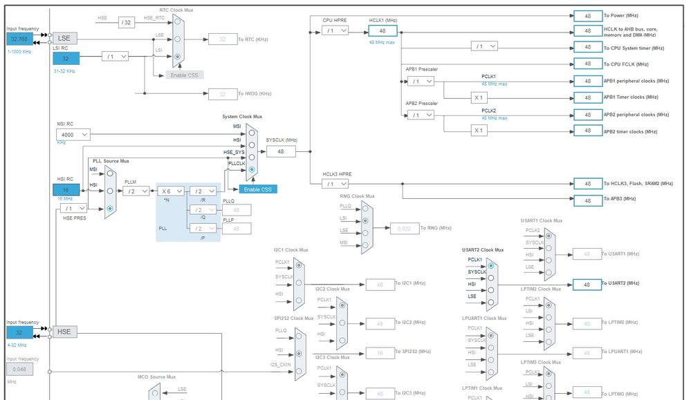

Then I started the Cube-MX (latest, fresh update...), selected the nucleo WL55 from the board selector, initialized the periphery with board, changed RCC HSE settings to Crystal/Ceramic Resonator and changed the clock configuration to
When I compile and debug the project generated by Cube, the execution quits in error handler when the __HAL_RCC_GET_SYSCLK_SOURCE() is called (stm32wlxx_hal_rcc.c, line 347). The HSE status in RCC Control register remains 0 (HSE not ready).
