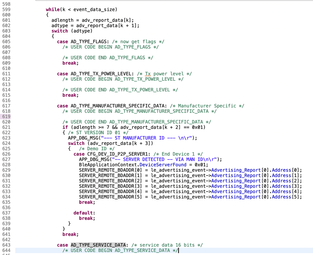

You can look BLE_p2pClient example available in STM32CubeWB package. This example shows how to demonstrate Point-to-Point communication using BLE component (as GATT client). In this example, the central device (BLE_p2pClient) starts scanning when pressing the User button (SW1) then when BLE_p2pServer is detected, it automatically connects to it. In the code you can look in app_ble.c file into SVCCTL_App_Notification function in the case HCI_LE_ADVERTISING_REPORT_SUBEVT_CODE, that decode the advertising report.

If the advertising data of your sensor contains it UUID service, you should add a case on the AD type corresponding to the UUID service and check if the UUID value matches with the UUID expected.

In app_ble.c file, see SVCCTL_App_Notification function:
case HCI_LE_ADVERTISING_REPORT_SUBEVT_CODE:
uint8_t *adv_report_data;
/* USER CODE BEGIN EVT_LE_ADVERTISING_REPORT */
/* USER CODE END EVT_LE_ADVERTISING_REPORT */
le_advertising_event = (hci_le_advertising_report_event_rp0 *) meta_evt->data;
event_type = le_advertising_event->Advertising_Report[0].Event_Type;
event_data_size = le_advertising_event->Advertising_Report[0].Length_Data;
/* WARNING: be careful when decoding advertising report as its raw format cannot be mapped on a C structure.The data and RSSI values could not be directly decoded from the RAM using the data and RSSI field from hci_le_advertising_report_event_rp0 structure. Instead they must be read by using offsets (please refer to BLE specification). RSSI = (int8_t)*(uint8_t*) (adv_report_data + le_advertising_event->Advertising_Report[0].Length_Data);
adv_report_data = (uint8_t*)(&le_advertising_event->Advertising_Report[0].Length_Data) + 1;
k = 0;
/* search AD TYPE 0x09 (Complete Local Name) */
/* search AD Type 0x02 (16 bits UUIDS) */
if (event_type == ADV_IND)
/* ISOLATION OF BD ADDRESS AND LOCAL NAME */
while(k < event_data_size)
adlength = adv_report_data[k];
adtype = adv_report_data[k + 1];
switch (adtype)
case AD_TYPE_FLAGS: /* now get flags */
/* USER CODE BEGIN AD_TYPE_FLAGS */
/* USER CODE END AD_TYPE_FLAGS */
break;
// ADD HERE THE CASE THE MANAGE AD TYPE FOR UUID
} /* end switch adtype */
k += adlength + 1;
} /* end while */
} /* end if ADV_IND */
break;Best Regards

I want to know this, too. I captured my custom board (Gatt Server) advertisement inside the case statement. by modifying to this line.
else if(adlength >= 4 && adv_report_data[k + 2] == 0x12){
switch (adv_report_data[k + 3])
My problem now is I can't read the data sent by my custom board (Gatt Server) to the client board (Gatt Client) which is the nucleo. Is there I had missed where I can input the Service UUID?
