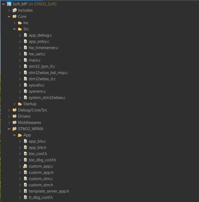

I'm trying to add a new file Alarm.c to my project. I added it in the Core>Src folder but I want to use it in a custom_app.c file that is located in another folder (STM32_WPAN>APP) as I use BLE. I included it to this file but when I compile, it doesn't find it in this file. How can I do to declare Alarm.c in one location and all my project's folder can find it?

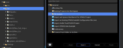

To let the IDE know, some (.c or .h) file now part of your project, you have to use : import.
So right click on the folder you want it to be, -> import -> from file sytem -> next ...

Thank you for your answer. I simply created a new .c file in the Core>Src folder. I am new to STM32CubeIDE and C programmation. I would like to create a .c file with different functions in it that are used in main.c and custom_app.c files. How can I do this ?

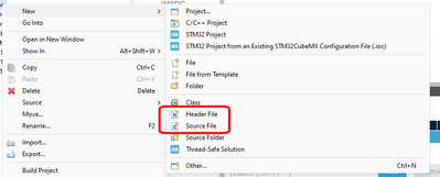

2024-02-20 4:06 AM
Almost same: right click on the folder you want it to be, -> new -> Source file
+ give name (no spaces, no special characters) , like : my_new.c
Thats it.

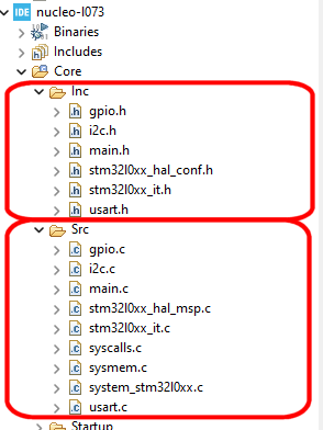

You will also need to create a .h "header" file - use the same approach:
The header file contains extern declarations of the things you want to be shared with other source files.
To use it, those other source files will need to #include the header.
https://c-faq.com/decl/decldef.html
To be sure that the compiler will be able to find the header, it must be in a folder that's included in the Include Paths.
The auto-generated ST code tends to have separate folders for source (Src) and header (Inc) files; eg,
This is a matter of style that you may or may not wish to follow...
