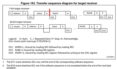

There's no way to do this with the STM32F4 I2C peripheral. There is no delay between bytes 1 and 2 when receiving. EV1 kicks off two bytes of reception.
I see two possibilities:
  • Bit bang I2C.
  • Act as a slave in the same bus and stretch the clock yourself.
  • Bit bang I2C.

TDK, thank you for the definitive response. I studied that diagram in the reference manual (that has slight different text than the version I was using), but never picked up that it indicates the two bytes must be sent back to back. Thanks.
