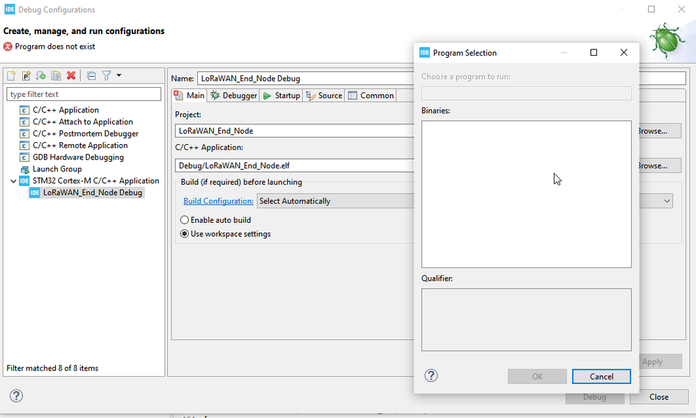

I faced the elf file errors again. what I do to fix this problem.
I successfully created an elf file when starting a new project. But occasionally when I ran the debugger, an elf file problem occurred. Please provide a solution to this issue.

2022-07-21 9:54 AM
I'm not interested in the absence of a created file when build fails to complete.
What would be helpful is any messages that appear in any of the windows in response to your request to build the project when you right-click on the project (IDE icon) in the Project Explorer and do "Build Project"
Without that, I can't help you.
2022-07-23 11:37 PM
thank you for your guidance @Danish
I solved the elf file error with your guidance.
