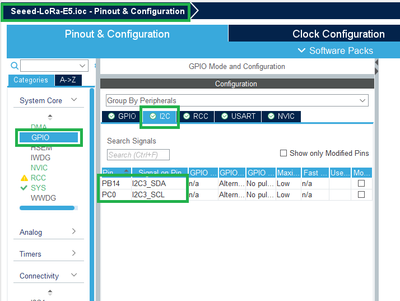

This image shows two rows of pin labels: one grayed and the second colored. In my infrastructure, I use I2C3 with pin connections according to MX configuration from STM32CubeIde:
This connection configuration works for me for several sensors.
I tried to activate other I2C interfaces, but I didn't find a pair of pin connections that matched the MX views for all I2Cs.
