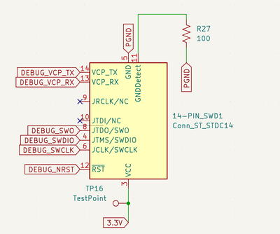

I have a 14-pin connector and a 6-pin fall back connector. I can connect the 6-pin SWD via st-link V2 on a nucleo board but I cannot connect with a V3 MINIE on the 14-pin. Any ideas? I followed the schematic for a 14-pin connector I found on a NUCLEO board, which had a 100 ohm resistor on GND detect. I have bypassed it but the result is still the same. Apart from that and the TX/RX, the wires are the same for the 6-pin connector that works?

2026-04-13 12:47 PM
I've just noticed that the footprint of the connector has pins 5 and 6 mixed up. Anyone have any ideas for removing the trace connecting pins 6 and 7 under the 14-pin connector (hahaha!)? Thank God for the 6-pin fallback the board has. And thank you for your willingness to help.

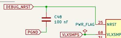

It can't, although I connected my MINIE V3 to a nucleo board so that's not the problem.
I followed this schematic (https://www.st.com/resource/en/schematic_pack/mb1549-u575ziq-c03_schematic.pdf) but the 100 nF capacitor on NRST doesn't seem to go to zero when I connect the debugger. It gets to about 1.8V. One thing I didn't do is add the ESD protection.

2026-04-13 7:08 AM
I copied the nucleo schematic I linked earlier.

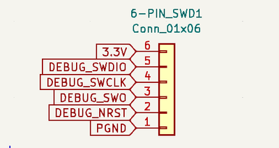

2026-04-13 7:12 AM
And here's the 6-pin connector.
2026-04-13 9:04 AM
Schematic is okay. Maybe the footprint on the connector is wrong, or it's installed in reverse.
2026-04-13 9:17 AM
Or an error in the wiring between the ST-Link and the connector ...
