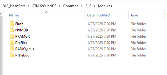

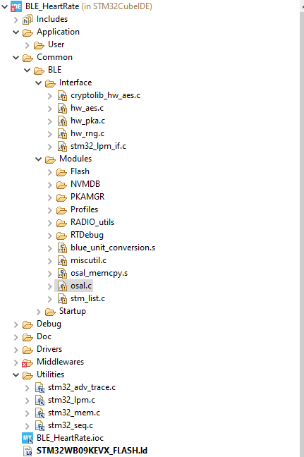

After importing the example project, it turns out that project is missing a lot of files.
When trying to find the osal.h file, I found the osal.c file in the Modules folder but you can see it has a broken link icon along with other files.
When looking at the Modules directory in File Explorer, there is not one single c/h file in the root directory nor the other 6 folders.
