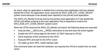

and I do not have access to my M0 core after this point. Before using the Bluetooth feature, I was starting the program from address 0x8050000 as I wanted and after that I had no problems. But after jumping, I can't access the shci functions at all and the program crashes. My problem is

First of all, thank you very much for your help. I will check. I want to ask you for one last help. I understand that Application Note clearly tells the point where there is an error. I am not sure if I understand correctly. When I do what is explained, I am missing something and I cannot get a positive result.
2024-09-08 8:09 AM
What i can give you more then what is on the Application note is to suggest you to try to understand how this procedure happend starting from one off our examples sych as this one. You can follow all the implemtation step by step or debug it to understand more about it.
