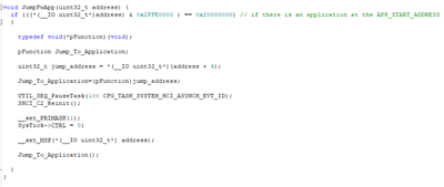

Hey everyone, I am using STM32WB55RGV7 processor. At the beginning of my bootloader program
if (((*(__IO uint32_t*)address) & 0x2FFE0000 ) == 0x20000000) // if there is an application at the APP_START_ADDRESS { typedef void(*pFunction)(void);
pFunction Jump_To_Application;
uint32_t jump_address = *(__IO uint32_t*)(address + 4);
Jump_To_Application=(pFunction)jump_address;
__set_PRIMASK(1);
SysTick->CTRL = 0;
__set_MSP(*(__IO uint32_t*) address);
Jump_To_Application();
I use the function and so my program jumps to address 0x8050000. When I jump to this program, I start with the commands

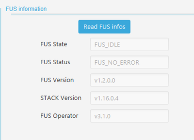

Hello @kazimk and welcome to the ST Community :smiling_face_with_smiling_eyes:.
Have you updated your FUS and stack? If so, have you clicked in the "start wireless stack" button? If so, please share your FUS and stack version (a screenshot from CubeProgrammer will be a good idea) and your option bytes values. Finally, tell me the source of you .bin FUS and Stack files (the version if STM32CubeWB).

Thank you for your interest. I have a Bluetooth feature that works normally. I upload a new stm32 fw file to address 0x08050000 with remote update on my system and tell my main program to start from here if there is a file here when starting. But after this point, when I try to call functions like APP_BLE_Init, it goes into an infinite loop. I think the starting address of the M0 core does not match and that's why I get an error.

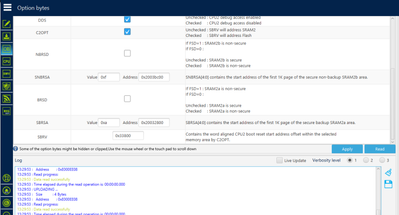

2024-09-08 4:19 AM
Could you please update the FUS and STACK, then click on the button "start wireless stack". After that, upload one of our ST examples and test if ot works or not. If you still have the problem, please share the values of the SBRV and SFSA option bytes. Also, read the content of the address 0x5800040c. Finally, read this wiki (specially the FAQ part).

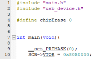

2024-09-08 4:30 AM - edited 2024-09-08 4:31 AM
I updated Fus and Stack and I click on the button "start wireless stack".
As I said before, I am having trouble because I made the starting address of my M4 kernel 0x8050000. The starting address of my M0 core is probably old so the bluetooth feature cannot start. I have a scenario like this. In my bootloader software, if I receive a broadcast from a bluetooth sensor (bluetooth feature is working), I jump to the 0x8050000 address with my JumpFwApp function. After this jump, after the __set_PRIMASK(0); and SCB->VTOR = 0x8050000; operations, my second software works successfully. However, my bluetooth feature does not work. If I try to run any of the APP_BLE_Init and schi functions, it loops. Because my M0 core does not work.

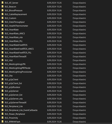

2024-09-08 5:18 AM
Try any example from our ble example on the STM32CubeWB V1.20.0. and perform test. Than send all data that i've asked for on the 3rd comment.
Best Regards.
STTwo-32

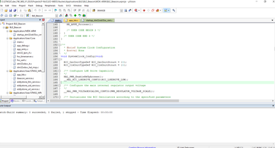

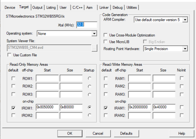

2024-09-08 5:37 AM
Sorry, I always have problems building in sample projects. I think we won't be able to find a solution this way. If we can't find a solution other than what you said, thank you anyway. There is just one thing I am curious about. I am making the settings via Keil. It is said on the internet that the starting address of the M0 core can be changed. I couldn't find a way to do this, or it was said that I can change the starting address of the M0 core from the option bytes options. Is there such a method?
