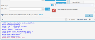

This is the error during FUS, when I don't enable "Start  address automatic determination"
(Firmware update is successful when enabling )
