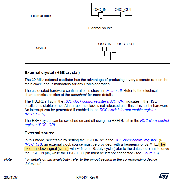

Another question: In the reference manual RM0434, it is specified, that an external clock has to have a sinus signal. I haven´t found many external clocks with a sinus. 99 % of them have a rectangle. If I use the MCO (master clock output) to output the clock of the external crystal, I also see a rectangle in the oscilloscope.

@LCE wrote:Interestingly, the WB series doesn't seem to support active oscillators. AFAIU it's because of the trimming which only works if the STM controls the complete feedback loop.
