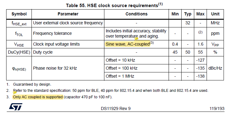

Thanks for the information! Yes, a crystal does not generate a signal by itself but is used as a part of the oscillation circuit and driven by the microcontroller to generate an oscillating signal . Is this signal square wave or sinus?
Regarding the requirement for the HSE signal: I was using an older revision of the datasheet. Interesting how things change. 1,6 V (max.) Vpp means a signal from 0 V to 3,2 V (max.) should suffice, right? I would probably go for 3 V as voltage, because this is the voltage I use for the microcontroller.

2023-12-04 2:40 AM - edited 2023-12-04 2:41 AM
no - is too much. give 1,6V vcc to the oszillator, then it will output 1,6vss sqw. , thats according to ds.
10nf + 75 ohm in series , so its AC coupled.

2023-12-04 3:05 AM - edited 2023-12-04 3:06 AM
@AScha.3 wrote:>1,6 V (max.) Vpp means a signal from 0 V to 3,2 V (max.) should suffice, right?
I am pretty sure Vpp should mean voltage peak to peak. If I run the microcontroller at 3 V (Vdd), I do not want to use an extra LDO or something just for the HSE.

2023-12-04 3:54 AM
-- so use some 3 diodes series forward , to get the voltage down for 1,6v at the osz.
and i am sure. at 3V the osz. will output 3Vss .

2023-12-04 4:00 AM
Would someone from ST please clarify, if 1,6 V Vpp means that the HSE oscillator input can be as high as 3,2 V or 1,6 V (DS11929)?
