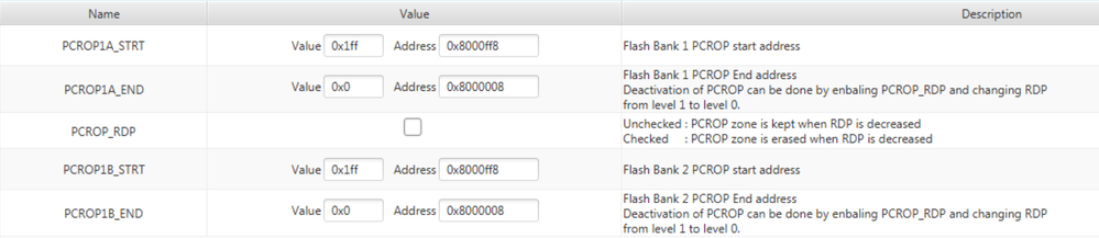

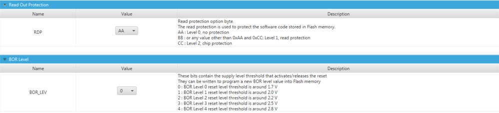

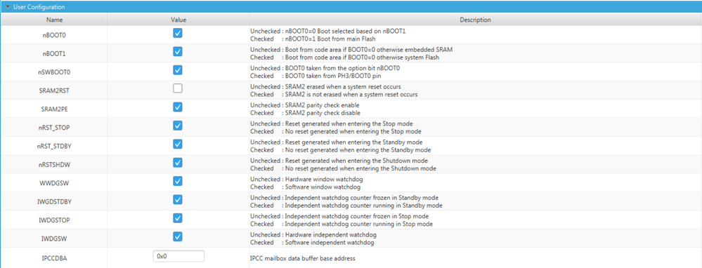

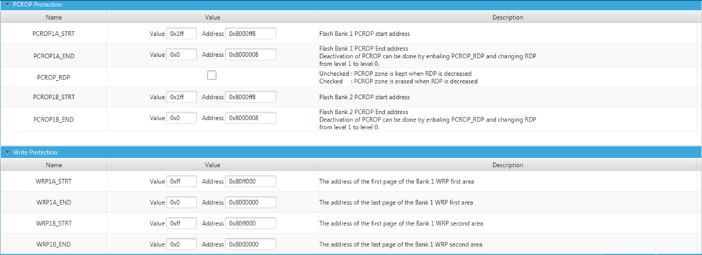

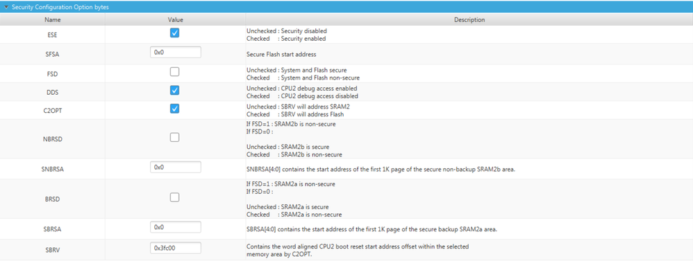

Tried that, and my controller is now permanently read-protected! I am unable to revert it to its normal functionality.
Please find attached screenshots of the current status of the option bytes.
It would be really appreciable if anyone could guide me to the current state of my device, and whether it is recoverable.
