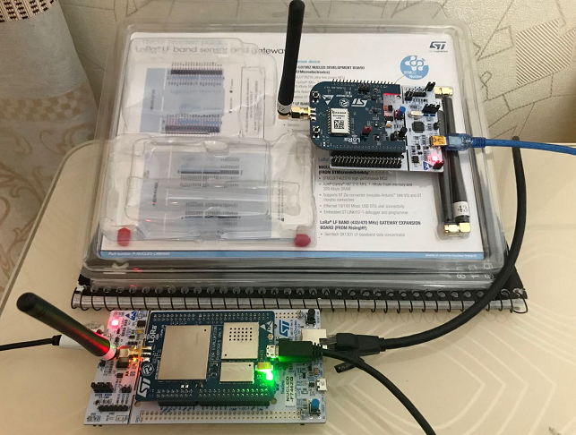

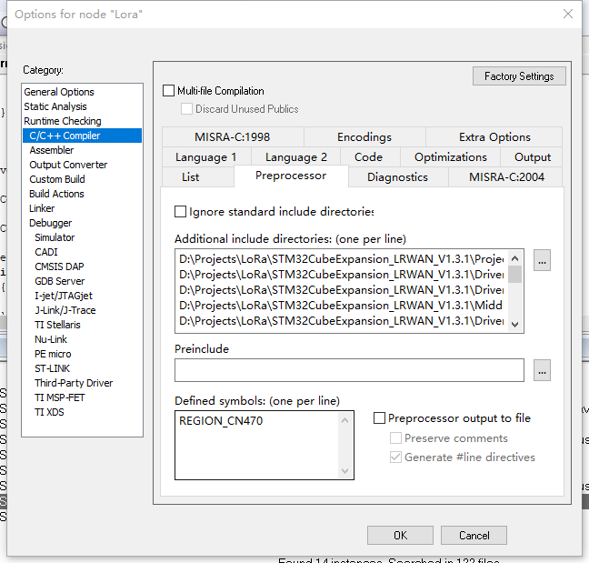

I'm currently trying to run End_Node project on my P-NUCLEO-LRWAN3 sensor board, I loaded the workspace to my EWARM IDE from STM32CubeExpansion_LRWAN_V1.3.1\Projects\STM32L073RZ-Nucleo\Applications\LoRa\End_Node\EWARM.
Problems
(1) I download and run the firmware to the NUCLEO-L073RZ NUCLEO development board, and reset the board, I got a LORAMAC_STATUS_BUSY and PHY txTimeOut message.

so I guess, it might be a problem of the antenna, and the "soft" reset does not work well; so I reset the board by pressing the reset button(black) on the NUCLEO-L073RZ NUCLEO development board, meanwhile reset the antenna by pressing NRST button on the LoRa LF BAND (443/470 MHZ) sensor expension board. And this time the message shown in the console is as follows:

#define OVER_THE_AIR_ACTIVATION 1
* When using ABP activation the MAC layer must know in advance to which server
* version it will be connected.
#define ABP_ACTIVATION_LRWAN_VERSION_V10x 0x01000300 // 1.0.3.0
#define ABP_ACTIVATION_LRWAN_VERSION ABP_ACTIVATION_LRWAN_VERSION_V10x
* Indicates if the end-device is to be connected to a private or public network
#define LORAWAN_PUBLIC_NETWORK true
* IEEE Organizationally Unique Identifier ( OUI ) (big endian)
* \remark This is unique to a company or organization
#define IEEE_OUI 0x8C, 0xF9, 0x58
* When set to 1 DevEui is LORAWAN_DEVICE_EUI
* When set to 0 DevEui is automatically generated by calling
* BoardGetUniqueId function (it is 0 by default)
#define STATIC_DEVICE_EUI 1
* Mote device IEEE EUI (big endian)
* \remark see STATIC_DEVICE_EUI comments
* IT WAS { IEEE_OUI, 0x01, 0x01, 0x01, 0x01, 0x01 } BY DEFAULT
#define LORAWAN_DEVICE_EUI { IEEE_OUI, 0x20, 0x00, 0x00, 0xF5, 0x2C }
* App/Join server IEEE EUI (big endian)
* IT WAS { 0x01, 0x01, 0x01, 0x01, 0x01, 0x01, 0x01, 0x01 } BY DEFAULT, USED AS AppEUI
#define LORAWAN_JOIN_EUI { 0x6D, 0x09, 0xAA, 0xAA, 0xAD, 0x20, 0x4E, 0x72 }
* Application root key
* WARNING: NOT USED FOR 1.0.x DEVICES
* IT WAS { 0x2B, 0x7E, 0x15, 0x16, 0x28, 0xAE, 0xD2, 0xA6, 0xAB, 0xF7, 0x15, 0x88, 0x09, 0xCF, 0x4F, 0x3C } BY DEFAULT
#define LORAWAN_APP_KEY { IEEE_OUI, 0x20, 0x00, 0x00, 0xF5, 0x2C, 0x6D, 0x09, 0xAA, 0xAA, 0xAD, 0x20, 0x4E, 0x72 }3. the device and gateway have been registered on the cloud (server) correctly.
