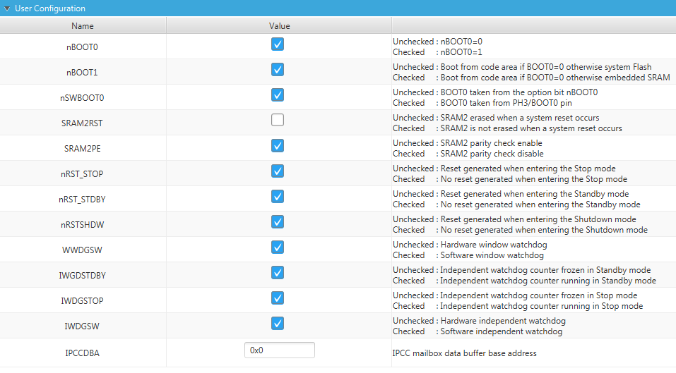

2019-09-27 3:53 AM
Hey @Remi QUINTIN , we are using a custom board.
Option byte boot0 is set from what I see, in the picture the user option bytes that I read from cubeProgrammer in dfu mode.

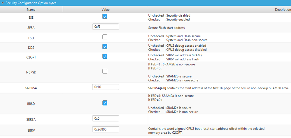

2019-09-27 4:08 AM
and here the security configuration OB
