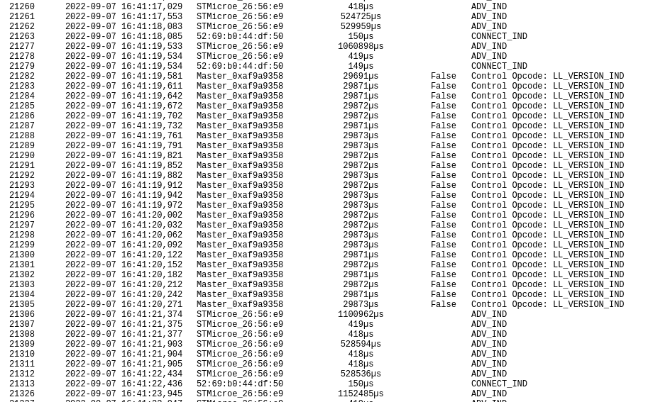

My custom device with custom firmware don't respond to LL_FEATURE_REQ so the device disconnect.
The connectivity part of my project is very similar to the example BLE_p2p_server, the device start advertising and when I connect to it with the mobile app ST BLE TOOLBOX the connection fail, in wireshark I see the master device is sending LL_FEATURE_REQ but the device doesn't respond.
Can you please help me as I'm stuck for a week now?
I share with you the wireshark logs (remove the .csv extension)
MCU : STM32WB55
Stack: stm32wb5x_BLE_Stack_full_fw.bin v 1.13.1
Thanks by advance for the help.

2022-07-11 8:32 AM
2022-07-11 8:43 AM
2022-07-12 8:58 AM

2022-09-08 1:02 AM
Hello, sorry for the late response due to summer vacations.
I don't have a phone with android 12, but I tried with Iphone 12 IOS 15.6.1 and the result is the same:

2022-09-12 9:13 AM
Resolved by setting CFG_BLE_LSE_SOURCE to 1 in app_conf.h
Do you have more explanation?
