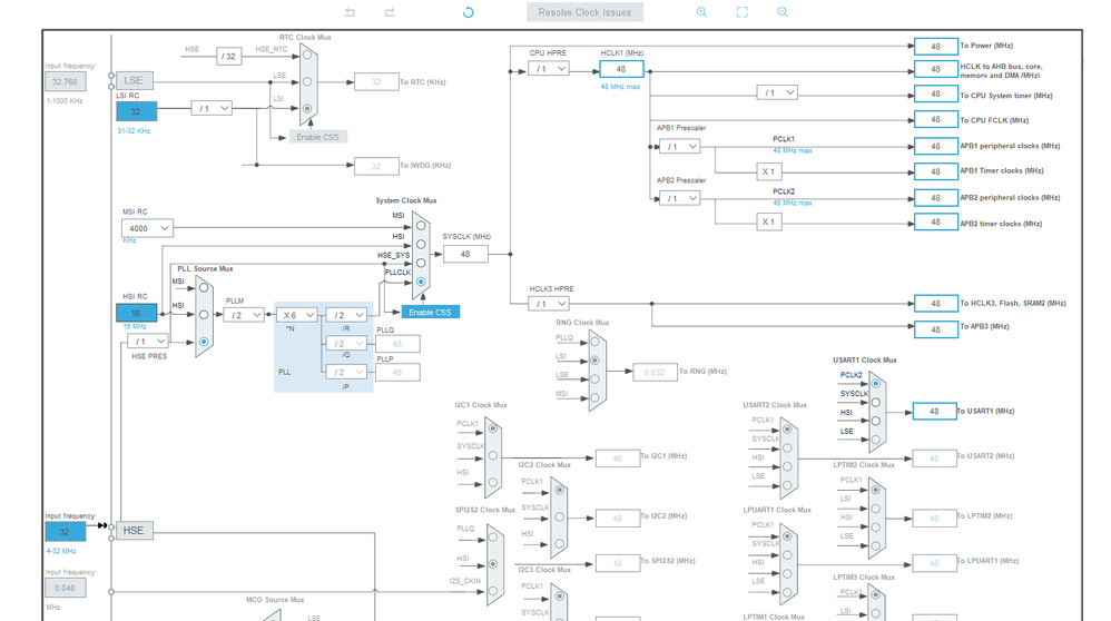

#endif /* USE_FULL_ASSERT */My clock tree:
Any help is greatly appreciated.
