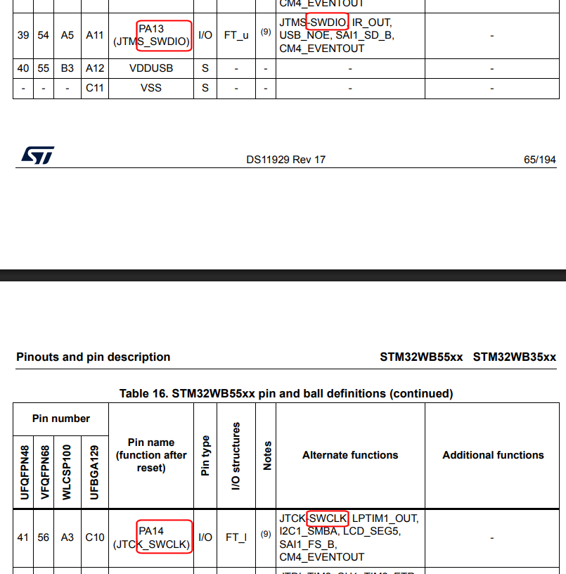

@GYV wrote:debug fails (lose connection) when executing debug_init. In fact debug_init creates the problem when programming pa13.
Please show that code. See: How to insert source code
PA13 & PA14 carry the SWD signals (ie, the signals the debugger uses to communicate) - so messing with them will break the debugger connection!
https://www.st.com/resource/en/datasheet/stm32wb55rg.pdf#page=65
via: https://www.st.com/en/microcontrollers-microprocessors/stm32wb55rg.html#documentation
