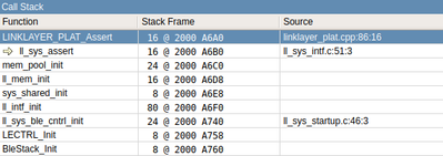

I am still getting an assert failure while calling BleStack_Init(). I get the failure in both stm32wba_ble_stack_basic.a and stm32wba_ble_stack_full.a.
Here is the call stack at the time of failure using stm32wba_ble_stack_basic.a and LinkLayer_BLE_Basic_lib.a.
The failure occurs in mem_pool_init(). Unfortunately, the assert doesn't come with an error code or a cause.
Any idea what the cause might be and how to fix the failure?
