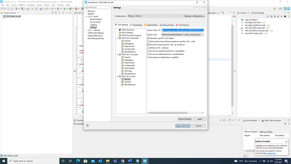

i went through the link. It was indicating G++ linker. But i had gcc linker in settings. Really cannot understand what to change there.
in linker script: ${workspace_loc:/${ProjName}/STM32H743IITX_FLASH.ld}
