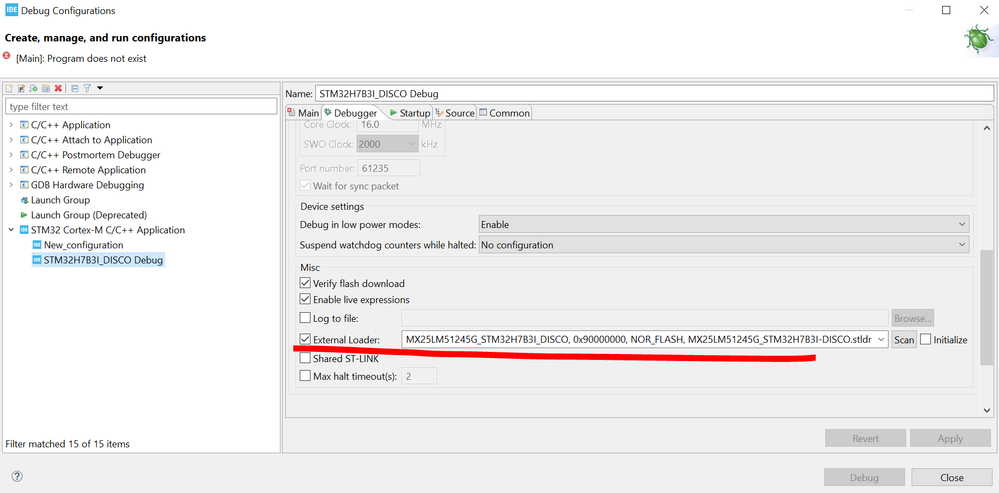

I am using touchGFX Designer 4.17.0 and CubeIDE 1.6.1. I have a stm32h7b3i-dk board and started with a blank UI, added two screens and two buttons, nothing too fancy. I was able to run my project on my board directly from touchGFX. Now I can build the project in the IDE but when I want to upload my code to the board via the IDE I am getting the following error message:
Failed to execute MI command:
load /Users/***/CubeMX_Export/MyApplication_4/STM32CubeIDE/Debug/STM32H7B3I_DISCO.elf
Error message from debugger back end:
Load failed

I can see, that the board starts to communicate with my MacBook and then something aborts it. With other projects I have no issues like that. Do you have any clue what this could be?

2021-07-06 6:21 AM
The Debugger connection lost and Shutting down is normal.
Could you try to go to the "Debug (or Run) configuration" by right clicking on the project name again, then hover above the "Run As" or "Debug As" options, then click on "Configuration" ?
Then in the popup, go to the "Debugger" tab, scroll down until the Misc section and check if the right External Loader is selected. If none are shown then click on the scan button on the right to see the list of available external loaders.
/Romain
2021-07-06 8:31 AM
There was no external loader selected, so I selected the one from your pic. got a step further and now have a problem with the CubeProgrammer:
