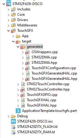

I have installed the new Touch GFX 4.17.
Created a blank project for F429_disco
Open CubeIDE, create new project from existing IOC file, but can't compile the project.
Is it the right way to do it ?
Tanks for your help.
/BR
2021-07-02 1:08 AM
When you create a project from TouchGFX Designer with the TouchGFX Board Setup (new name for Application Template) for the STM32F429 disco board and generate code from TouchGFX Designer, a fully configured STM32CubeIDE project will be generated for you. To open it you just have to double click on the .cproject or .project under the <project name>/STM32CubeIDE folder (no need to use the "create new project from existing IOC file" option).
/Romain
2021-07-02 1:14 AM
Hi BParh.1,
Now that TouchGFX 4.17 it is in our plan to improve the dynamic graph and we take into accounts your ideas/suggestions. I do not have an estimated date of release. If you have more inputs please add them to the Idea Zone of this forum, this will help us keep track of it. I know I always write this down but we do take into account those ideas but just lack time/man power to be honest to do them all as fast as we would wish :grinning_face_with_sweat:.
/Romain
2021-07-02 1:53 AM
thanks, it works fine.
After, is it possible to import IOC file to make modification on the components use on the board ?
/BR
Laurent
2021-07-02 2:01 AM
In the project generated you already have an ioc file as well which you can modify. Otherwise yes it is fine to import IOC file but you just have to make sure to correct all the paths.
