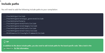

I would guess that you did not include all the files that need to be included. In the last link you share, we do recommend files to include but this is not all of them as we say in the green box:

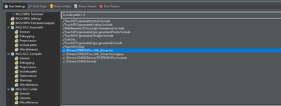

I did the above project on the discovery board. I was getting those error. actually i am developing this for a custom board. As the touchgfx documentation say, i added crc, dma2d, ltdc and verified the iroc. i have few other peripherals running as well. then added xcubetoughgfx and generated code. unfortunately, cubemx does not setup correct path to souce and include file for cubeide. I had added the include path as shown in the picture.

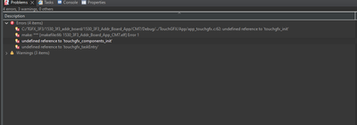

when the cubemx project created the first error i got is it has not included no such file as app_touchgfx.h. then i added that then it shows below error

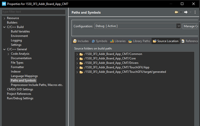

I guess the project does not see app_touchgfx.c for some reason. I was expecting cubemx and ide to do this for me. I added path to source file as show below,
this does not help. Is there a way to fix this. This is a custom board on stm32h745 and the touchgfx and dependent peripherals are running on M7. I am using the latest version of all software from ST. I have to meet a deadline and adding everything manually is time consuming and i am pretty new to touchgfx and cubeide and I don't where i am heading by adding the paths manually.
