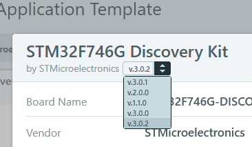

@Martin KJELDSEN I've installed TouchGFX Generator 4.15 via CubeIDE, I've selected the Software Packs with settings: LTDC, Double Buffer, By allocation, ChromART and when the files are generated a "ApplicationTemplate.touchgfx.part" is also created. When I double click TouchgGFX designer does not open at all, the only thing opening is the file stating:
(I still have the old TouchGFX 4.10 installed (not in CubeIDE), does that matter?)
"Application": {
"Name": "stm32f746cubeide",
"TouchGfxPath": "../Middlewares/ST/touchgfx",
"AvailableColorDepths": [ 16 ],
"AvailableLCDs":
"16": "LCD16bpp"
"AvailableResolutions" : [
"Width": 480,
"Height": 272
"PostGenerateTargetCommand" : "touchgfx update_project --project-file=../stm32f746cubeide.ioc --platform=m7",
"Family" : "STM32F7"
"Version": "4.15.0"
How can I open TouchGFX designer?
2020-11-09 12:14 AM
Hi, if you've installed the X-CUBE through CubeMX/CubeIDE then the installer for the designer is in the X-CUBE pack folder which is here:
C:\Users\<you>\STM32Cube\Repository\Packs\STMicroelectronics\X-CUBE-TOUCHGFX\4.15.0\Utilities\PC_Software\TouchGFXDesigner
