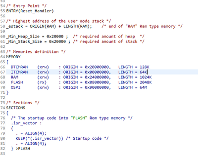

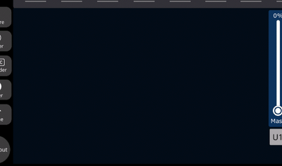

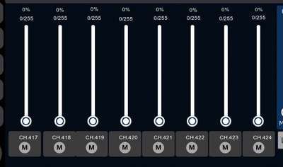

2024-08-19 2:33 AM
I've increased the heap allocation
but it doesn't change anything. The container is displayed until page 53
but after that the swipe container page is empty.

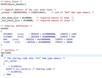

I tried to do the same thing for flash memory :

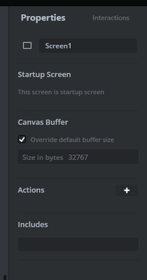

I also changed the buffer value for the screen :
Do you have any solutions, please?
