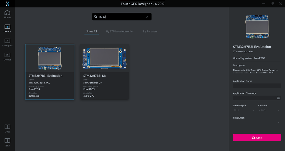

Are you using the available TouchGFX Board Setup (TBS) for STM32H7B3I-Eval?
TBS for STM32H7B3I-Eval

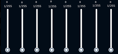

I am working on creating a mixing console with 512 sliders. I have created a page with 8 sliders, and it is necessary to swipe to switch from one set of sliders to another. Above each slider, I want to display its value. My problem is that to display the value of the slider, I have to create a new interaction for each one.
I would like to know if TouchGFX can handle more than 512 interactions and if there is a simpler way to achieve what I want.
