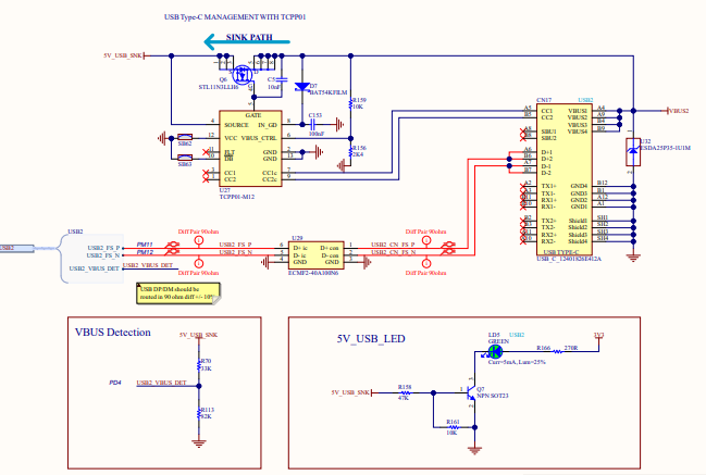

> Could you perhaps give us some guidance or a hint on how this should be implemented correctly?
I recommend using USB TypeC connector and TCPP01 protection port. Here is an example.
