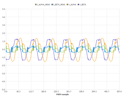

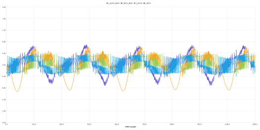

Here are the graphs from when the setpoint is set above 7kRPM:
And below 7kRPM:

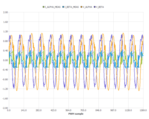

The motor does now spin up to 10-12kRPM. It is rated up to 50kRPM, but I guess there's going to be a limit with the PWM and controller bandwidth. Here are the logs at 10kRPM.

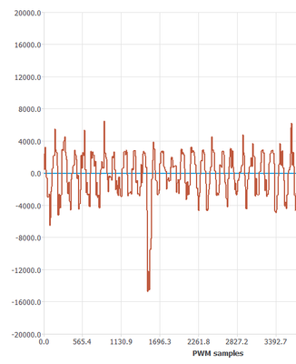

As for sensorless control, I do get a startup failure (FAULT_OVER) error when closed-loop takes over from sensorless, which I suspect has to do with the back-EMF sensing. Plotted below is what the back-emf observer outputs when the motor is ramped in open loop to 4kRPM and held there for 5 seconds.
