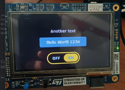

I've created a test touchGFX project for stm32h747i-disco by using TouchGFX Designer-4.21.4. It has only one screen that has one background image and one text. You can see it below:
When I generate the code by using TouchGFX Designer-4.21.4 and when I compile and download it with stm32CubeIDE, it works without any problem.
