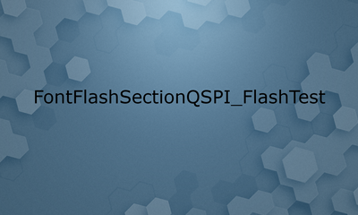

I've created a test touchGFX project for stm32h747i-disco by using TouchGFX Designer-4.21.4. It has only one screen that has one background image and one text. You can see it below:
When I generate the code by using TouchGFX Designer-4.21.4 and when I compile and download it with stm32CubeIDE, it works without any problem.

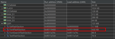

But when I write this linker code to move FontFlashSection into QSPI flash memory, it stucks in the ErrorHandler.
FontFlashSection :
*(FontFlashSection FontFlashSection.*)
*(.gnu.linkonce.r.*)
. = ALIGN(0x4);
} >QSPI
ExtFlashSection, FontSearchFlashSection and TextFlashSection work in the QSPI flash memory without any problem. But when I add FontFlashSection as well to the QSPI Flash, the code somehow stucks in the ErrorHandler.
What else should I do to use FontFlashSection in QSPI Flash memory? What am I missing? Can you help me for this? I need to use FontFlashSection in the QSPI Flash memory. Thank you for the answers :)

Thank you for the answer. I tracked down in the code. After the function being called below, it goes to the ErrorHandler.
const uint8_t* GeneratedFont::getPixelData(const GlyphNode* glyph) const
const uint8_t* const* table = (const uint8_t* const*)glyphData;
return &(table[glyph->unicode / 2048][glyph->dataOffset]);
}Also, I have checked some of the TouchGFX examples for the stm32h747i-disco. Unfortunately, FontFlashSection is being used in internal flash memory in these examples.
