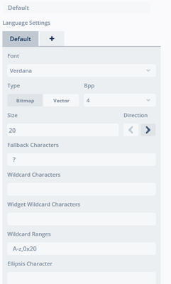

I created a texts called genericText that uses a default font that has wildcard range 0x00-0xFF , I also tried having range 0x20-0x7e and wildcard character 0x0A (/n)
here is the text and typography:

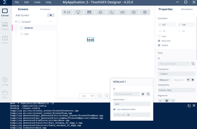

Here is the screen with text area:
in baseview.cpp it creates:

Here's my text config :

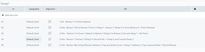

like this?
It still will not acknowledge \n
wait I can make it like this:
2025-07-25 8:02 AM
Like that!

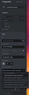

Another option is to add text wrapping to your text box, but I suppose you don't as much control around how it wraps.
Our text box is in a container,
And then our code chooses which of three errors to display (via custom title, image, and text) like so (sanitized version):
