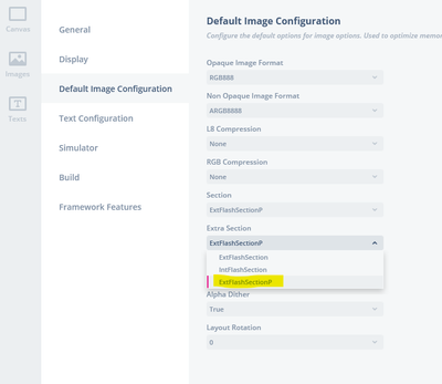

Hello @drJonesy ,
Yes quite easy (but hidden feature). Open your touchgfx file with a text editor and add your new ExtFlashSectionP section like such:
"AvailableSections": [
"ExtFlashSection",
"IntFlashSection",
"ExtFlashSectionP"
After that, you should be able to select it from the drop down list in your images settings for instance:
Your linker looks good to me. So with only the changes i mentioned above, it should be working.

2025-12-12 2:14 AM
Thank you very much Osman, Will try this and let you know.

2025-12-12 5:27 AM - edited 2025-12-12 11:53 AM
That was very easy. Thanks again Osman SOYKURT for your help.
Brief edit and update.
System is working well with Touch GFX loading the replaceable image to the new flash partition (so as to not effect the rest of the images stored) and loading new images from SD-Card to the flash partition. With this method I could add more partitions and load other images to separate sections.
