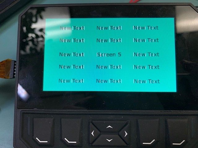

I generated a screen with several text fields to see if a pattern emerged and I've attached the capture to this post.
If you look closely, it doesn't appear uniformly on the same letters, but it does appear uniformly in columns. As an illustration of this, compare the lower case t in the upper left with the lower case t on the upper right and see that they do not both have the white line glitch. Then compare that same 't' in the upper left with all of the 't' characters aligned in a column beneath it and see that they all have the same glitch of the same width and height. This seems like a clue but I haven't yet determined its meaning.
