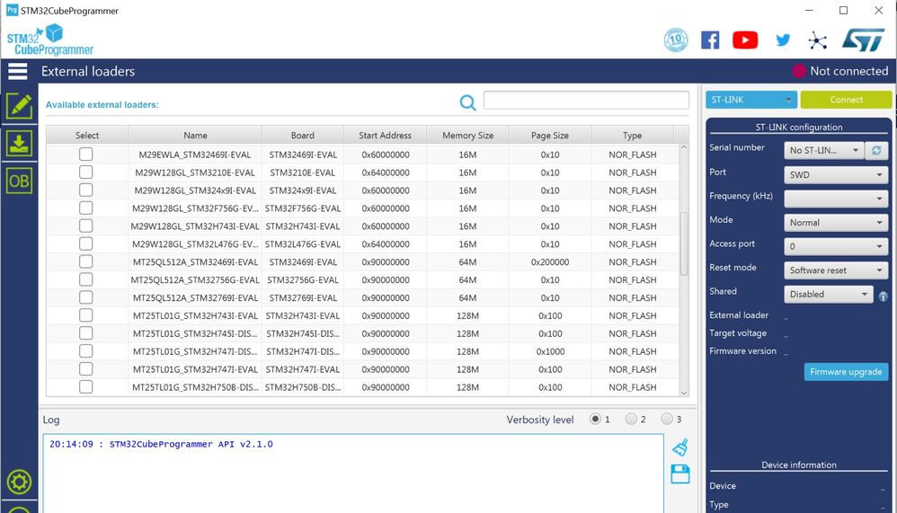

Download STM32CubeProgrammer. It has some external loaders.
2019-08-05 5:27 AM
Hi @hansd56
The external loaders in STM32CubeProgrammer are only for the specific ST boards.
I have already tried some loader in this tool and didn't get it working.
I think my board is only working with a customized loader.
Regards
Dejan

Thanks for all your responses.
I have tried to modify N25Q512A_STM32F769I-EVAL loader in Atollic TrueStudio. The build was successful and I renamed the .elf file to .stldr and copied it to the bin folder of ST Link-Utility and Cube Programmer. Both Tools are not displaying the modified external loader.
