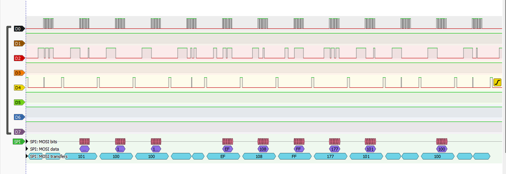

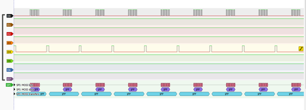

I’m experiencing unexpected behavior while testing 9-bit SPI on an STM32, observed with a logic analyzer. The issue only occurs when the MOSI line is physically connected to the slave.
Observations:
:keycap_1: MOSI not connected
  • CS and SCLK are correct
  • MOSI stays high
  • SPI decoder shows 0x1FF
  • Expected behavior for a floating MOSI line
:keycap_2: MOSI connected to the slave
  • MOSI data becomes correct
  • But a very brief rising edge (glitch) appears on CS during data transmission
  • CS immediately returns active → causes unintended slave deselection
  • Result: data loss during the SPI frame

This is signal noise due to cross-talk or a logic analyzer connection which is not ideal.
  • Measure the signal as close to the chip as possible.
  • Connect ground close to where you measure the signal.
  • Reduce pin frequency to the slowest possible that can still support the data rate.
  • Ensure logic analyzer is set to the same logic level as the signal.
