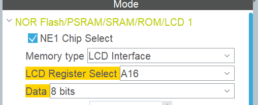

My problem is simple, probably silly. I couldn't find any answer, even in other working projects from the net. I can't enable TouchGFX in Middleware (I can only enable STemWin Display Bus Interface using FMC). What am I missing:
1.Connectivity->FMC

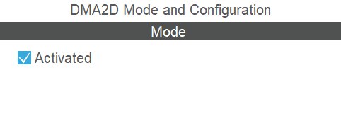

2.Multimedia->DMA2D

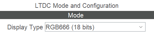

3.Multimedia->LTDC

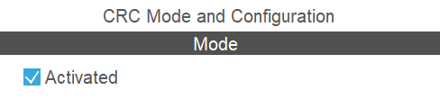

4.Computing->CRC

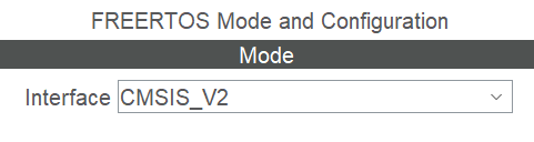

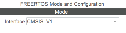

5.Middleware->FreeRTOS
And TouchGFX is still faded. What is wrong? I've checked DataSheet, Reference Manual, Errata, TouchGFX site, many other sites and somehow I am still missing something. Can you point my mistake?

As I said, solution is simple. There's lack of D letter in SRAM. The IDE/CubeMX requires SDRAM, not SRAM. The F429 series can hold external SDRAM but not in LQFP100 package, changing to LQFP144 solved the problem. Now I need to change nearly whole layout - next time I'll read technical documentation more carefully.
