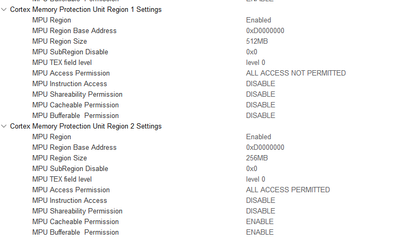

2024-04-22 11:18 AM - edited 2024-04-22 11:52 AM
That's great news, glad to be able to help you.
Please note that with MPU it is most likely possible to disable caching for just some memory area (framebuffer in this case (?)).
Br JTP
2024-04-23 12:34 AM
yes... this was my MPU set
