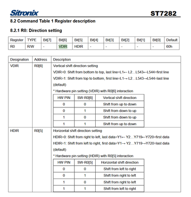

2025-07-31 6:15 AM
@MHoll.2 the LCD may even support it (see below) but the LCD SPI pins are just not present on the ever popular 40-pin FPC ribbon which makes things difficult.
2025-07-31 3:42 PM
I have a st7272a driver LCD,It has Vdir and Hdir.I tried to change these two bits,but have no use.
