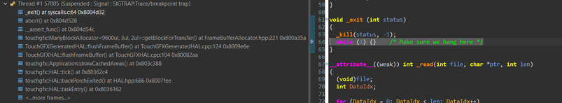

Hello!
I have an STM32F777 with FreeRTOS and TouchGFX. An SPI display is controlled in partial framebuffer mode via SPI4 and DMA. The implementation is the same as in the TouchGFX demo projects with partial framebuffer (NUCLEO_C071RB + GFX01M2). I have also attached my display SPI library.
The vSync signal is implemented at 60Hz via a software timer, as the hardware does not provide such a signal.
My hardware has an Ethernet port that provides a web server with the LwIP stack. This generates many interrupts during high data traffic, which puts a greater load on the processor.
During operation, this leads to a deadlock of TouchGFX after a few minutes. TouchGFX gets stuck in the function “getBlockForTransfer(Rect& rect)” in the line “assert(state[sendingBlock] == DRAWN);” (File: FrameBufferAllocator.hpp).
After that, the display is no longer updated.

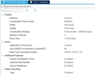

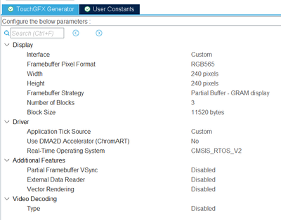

2025-08-18 11:15 PM - edited 2025-08-18 11:16 PM
Hello, I am using TouchGFX version 4.25.0.
I am uncertain whether I need to adjust the CubeMX configuration to enable the missing functions. I have searched the entire project but cannot locate the waitUntilCanTransferBlock function. Consequently, it is not being called.
You find attached an image of my settings. Do I need to adjust anything else?
Just as a reminder, I don't have a TE pin (the display doesn't have one) and vSync is generated by a FreeRTOS timer.
2025-08-21 11:23 PM
Hello Sandro,
You need to set the "Partial Framebuffer VSync" to enabled, to to have this weak function generated and called by the framework.
