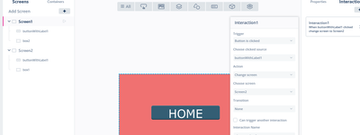

currently working on touchGFX(without RTOS)+stm32h723zgt6+ltdc display .
First Screen1 is coming with touchGFX but touch x,y coordinates not changing the screen2.
touchGFX screen1 interaction made as follows .
i do not attached any touch sensor ! instead of touch sensor i made manual touch x ,y coordinates input by following code . due to manual matrix key button for future use .

if(gate==2){tempx=0; tempy=0; gate=0;}i am trying to give x, y coordinates manually but no screen change .
