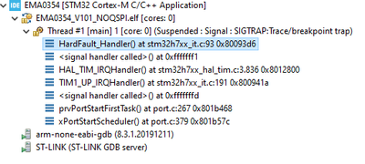

hardfault stack:
It happen at very starting point (I suppose when freertos need to start, becouse Tim1 is used for systimer
The MX_LWIP_Init() isn't called yet, but is compiled. To avoid hard fault, i need to comment it:
// MX_LWIP_Init();
The hardfault stack:
