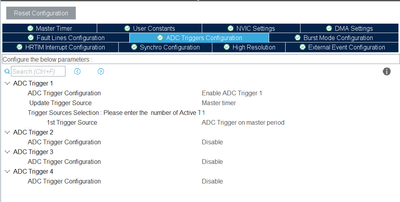

ADC configurations

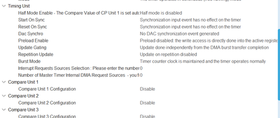

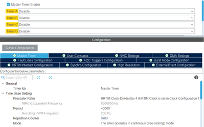

HRTIM configurations
