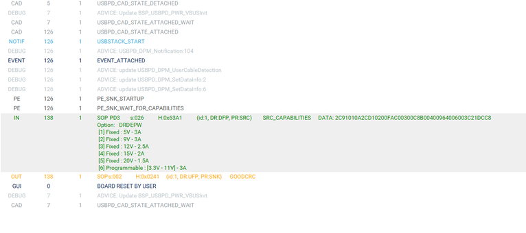

I am having big troubles getting USB-PD sink on the STM32G431KBT to work. I am using CubeMX and following the AN5418 Complete USB-PD application example and using FREERTOS 10.3.1 and USBPD 3.3.0.
Connected to my wall adapter the debug traces looks as follow:
The source always resetting its power after the source capabilities are recieved. And the board restarts.
Any ideas how to fix this?

Hi @BoSt
I assume the sink cannot evaluate the received source capabilities to determine the best power profile to request.
Did you check user code section dedicated for evaluating capabilities

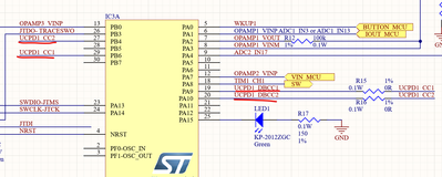

I have a minimal project with just one task blinking a LED. The MX_USBPD_Init(); are hanging up the program and not even the blink task is starting after the board has reset.
On my test board the UCPD1_CC1 and UCPD1_CC2 are connected directly to the USB-C connector and VBUS connected to a voltage regulator.
