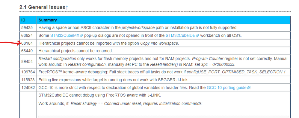

2023-03-10 1:43 PM
FYI, just saw this on the STM32VubeIDE wiki.
2023-03-13 3:03 AM
Hello ,
Consult the Stm32CubeIDE User Guide chap 2.10 not 2.1 or simply search on import existing project.
You can import a project as written on STM32CubeIDE User Guide without check "copy into workspace" : Because this option breaks a lot of links. The example projects usually have paths outside of the specific example, so when you try to build it can't find all the paths and throws an error.
