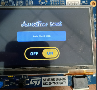

I am working on integrating TouchGFX into Zephyr and have made some progress. However, I am currently facing an issue where the text appears scattered and displayed strangely.
I have enabled DMA2D, and the font data is stored in external QSPI flash and loaded into external internal SRAM. My board is the STM32H750B-DK.
Any help or tips would be greatly appreciated. Could you possibly guess the reason by looking at the image? The texts are displayed better after I press the reset button following the initial flash
2024-10-15 9:54 AM
Try disable DCACHE

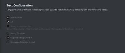

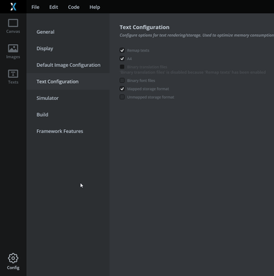

Can you share your font configuration from within TouchGFX Designer :

Hi Gaetan,
This is the text config:
I have tried different font sizes (and a different font from Verdana: Times New Roman). Still the same.
