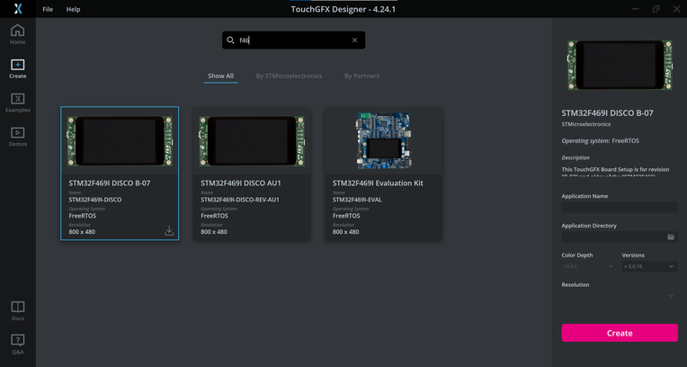

Then, open a new instance of TouchGFX 4.24.1, select the platform that you are developing on (for instance, STM32F469I Disco), and create a project:
STM32F469I Disco TBS

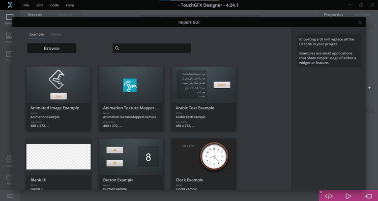

After that, click on Edit -> Import -> GUI. In the new opened window, click Browse and look for the project you converted to TouchGFX 4.24.1:
Import GUI
Now, you have your GUI in TouchGFX 4.24.1, and you should be able to run the simulator with no issues.
It is worth mentioning that you need to reapply the settings and custom code you have for the hardware parts (code related to the main.c file, UART connections, etc.)
